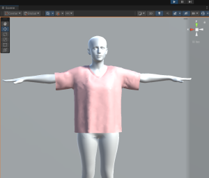

When I hit the play, however, rather the t-shirt (SkinnedCloth applied) maintains the original fbx form itself and drops towards the Y-axis like an object on a desk falls to the floor. It seems like no gravity affecting the clothes.

(29-04-2024, 09:57 AM)onfitpark Wrote: When I hit the play, however, rather the t-shirt(SkinnedCloth applied) maintains the original fbx form itself and drops towards the Y-axis like an object on a desk falls to the floor. It seems like no gravity affecting the clothes.
Not sure I understand your question. You both mention the object drops towards the Y axis, but that there's no gravity affecting it? If it's falling in the Y axis, it must surely be due to gravity?
In any case, adding a distance field to a collider doesn't affect gravity in any way, the cloth should fall due to gravity as usual.

(29-04-2024, 10:53 AM)onfitpark Wrote: Oh, it was my mistake. I mean the top drops towards the Y-axis without hanging over the body. That all.
Oh ok, so the cloth is falling but not colliding against the body right?
How does the distance field look in the preview? Can you see anything in the distance field inspector's preview window? (at the very bottom of the inspector, like in the following screenshot):

(29-04-2024, 10:57 AM)josemendez Wrote: Oh ok, so the cloth is falling but not colliding against the body right?
Cloth already contains its own collision geometry (particle-based), there's no need to add a MeshCollider to a cloth.

(29-04-2024, 12:00 PM)onfitpark Wrote: Hi,
I reset the Distance Field and applied again. This is the result I've got.
The preview looks really bad, the arms are missing and some parts of the model are way too thin, plus it only takes up 39 kb of space which means it's missing a lot of data.
Reduce the max error setting to a smaller value (0.00001, for instance), then regenerate the distance field. This error is a distance value, so if your mesh is small and the max error is comparatively large, the resulting distance field will do a poor job of approximating its surface as you're allowing a large difference between the distances stored in the distance field and the actual distance to the mesh surface.
