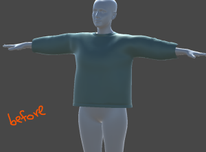

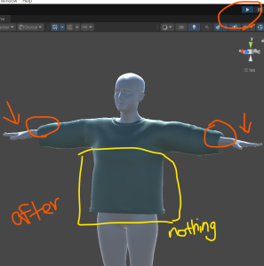

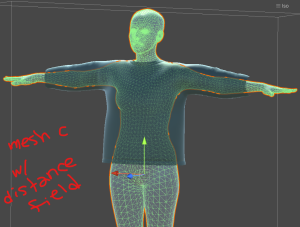

I got your suggestions and applied them, and seems better than previous works! And here I bring another question.
Once hit the play, the t shirt(Sorry for the poor image example below. I just randomly enlarge the size of the garment for a visible example) sleeves are stretching down and place on the arm but nothing is changed in the bodice part.
According to the principle, bodice part should be stretching (would rather say shrinking) towards the center of the body so that it shows how it looses. It seem like less affected by gravity.
What I want to try is that to make the cloth(t shirt) drops in the direction of gravity so that it attaches naturally to the mesh collider I'm using.
Is there any way to make it work, or any ideas to try?

23-04-2024, 12:58 PM
(This post was last modified: 23-04-2024, 01:00 PM by josemendez.)
(23-04-2024, 12:55 PM)onfitpark Wrote: Hi,
Thank you
I'm not sure I understand your question, sorry. If you're referring to the visible gap between the sleeves and the actual surface of the body, that's due to particles being too big.
In the blueprint editor, select all particles and change their radius to a smaller value. Note you can enable particle visualization in the visualization options at the bottom of the blueprint editor to better adjust the radius.
On my previous post I forgot to mention: set your ObiSolver's sleep threshold to zero in order to allow all particles to move even if their velocity is very small, this is important for capturing small details in the simulation.

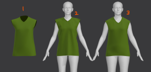

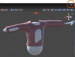

Somehow, I feel I need to add more details to my questions  I attached a example image so that I hope this will help you to understand(I wish I could show the project in person).
[Example]
1: original fbx
2: Once I put it on a S size body and hit the play, since it's loose in real world, the clothes fit and form a natural wrinkle, room, looseness(On my previous posts, I used the term like stretch, shrink, instead).
3: On a L size body, it fits tight bcuz there's no enough room between the body and the clothes.

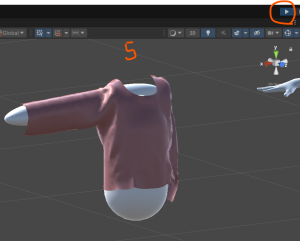

[Spheres with collider and Unity Cloth]
4. fbx and a basic sphere pretended oversize body
5. In the simulation, the sphere "wears" the fbx following the shape.
I'm looking for the way that the clothes fit on any body(w/ Mesh Collider) and are naturally placed following the shape of the body.
I pin my hope on Obi Cloth to bring 1,2,3 and/or 4,5 kind of principle into Unity engine. Somehow, I think this is a rare question in this forum world lol. I hope this helps you to understand my idea
I know these ideas will be explored in more detail. So far, manipulating skin radius and backstop in Blueprint, ObiSolver, sleep threshold, collision settings and all other advice you gave me. I'm grateful to you for all information.
Looking forward to your answer.
Thank you
*To lower down the particle distance of the clothes might be helpful, though? Obi Particle Renderer doesn't seem like what I want to try.... I have no idea about this....

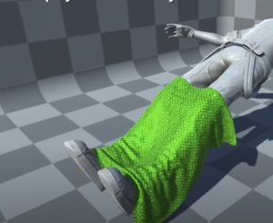

In the sample sources utilizing Obi Cloth, when the cloth drops down to the statue we can see the natural wrinkle and the face/chest/belt/shoes curve of the statue itself even though the cloth covers it while it's slipping. I'm moved by this so I'm interested and trying to get advanced result
However, this effect doesn't show in Obi SkinnedCloth. When I try this, any clothes seems like armors; hard, stiff, less flexible. Is there a method that I haven't known so far to actualize this with Obi SkinnedCloth?
If not, eventually, using Obi Cloth, is there a different way to optimize the effect(fabric!) with my avatar(only Mesh Collider).

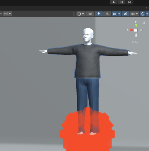

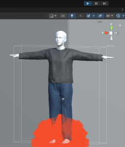

I have reached to put on the clothes(a top and a pants) and they look more natural. They are children of one ObiSolver, so they are under the same condition of Solver settings. For this, I've got high value of Constraint settings and some of them are over 8 up to 17 and, and substep got 15
When I simulate on, it starts jittering and colliding each other, and pass through the body mesh, and it gets slower.
I was wondering if you could help me optimizing performance; stabilization.
Thank you
Posts: 6,539
426
(29-04-2024, 02:35 AM)onfitpark Wrote: Hi,
8 iterations and 15 substeps = 120 iterations, which is *a lot*.
Substeps are a lot more effective at improving simulation quality than iterations. It is very rare for iterations to go over 2-4, as they're intended to adjust the relative importance of different constraint types. Usually, you want to keep all iteration values at just 1 iteration, then use as many substeps as needed. Then if any particular constraint type needs some extra strength, use a couple more iterations on that particular constraint type.
(29-04-2024, 02:35 AM)onfitpark Wrote: When I simulate on, it starts jittering and colliding each other, and pass through the body mesh, and it gets slower.
Is the body mesh a MeshCollider? it really should be a distance field instead as I suggested previously, this will prevent any particles passing trough the body. It's also much cheaper than MeshCollider.
(29-04-2024, 02:35 AM)onfitpark Wrote: I was wondering if you could help me optimizing performance; stabilization.
Performance is best optimized using the profiler. It will tell you *exactly* what's taking up more time, so that you can focus on optimizing that. I can help you interpret your profiling sessions, but can't optimize it for you since I would be simply blind-guessing.
