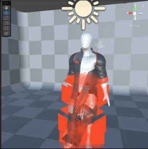

Btw, Im currently trying to make a trench coat following obi cloth proxy character cloth tutorial( Obi Physics for Unity - Character Clothing using Proxies (virtualmethodstudio.com)), but the particle keeps falling from the body! I know there is a issue about simulating sample of obi cloth proxy (CharacterCloth Scene in sample - cloth directory, Unity 2021 not working? (virtualmethodstudio.com)) But obi version of mine is 6.5, and version of unity is 2022.3.2 as you can see, and if I play the scene of Character Cloth, cloth mesh is broken like a screen below( this still happens my coworker's computer who using obi 6.5)
And this is a trench coat that I made with proxy following tutorial
I would understand if this happens only in CharacterCloth Sample scene, but even I used same model(I just copied from CharacterCloth scene) and made a coat blueprint with optimizing it, adding tethering group and generating tether,And I created trenchcoatSkin then added 2 channel, particle of the skinned cloth object keeps falling. Should I update obi from 6.5 to 7 or Did I something wrong? Thank you
*I got IndexoutofRnage exception from 128 line from ObiClothProxy.cs

(10-10-2024, 09:39 AM)gahyun11 Wrote: Btw, Im currently trying to make a trench coat following obi cloth proxy character cloth tutorial(Obi Physics for Unity - Character Clothing using Proxies (virtualmethodstudio.com)), but the particle keeps falling from the body! I know there is a issue about simulating sample of obi cloth proxy (CharacterCloth Scene in sample - cloth directory, Unity 2021 not working? (virtualmethodstudio.com)) But obi version of mine is 6.5, and version of unity is 2022.3.2 as you can see, and if I play the scene of Character Cloth, cloth mesh is broken like a screen below( this still happens my coworker's computer who using obi 6.5)
As explained in that link, Unity completely changed the way meshes are stored in Unity 2021. More specifically, 2021.2. This is not just a one-time/specific version thing, they changed the format permanently for all future versions. As a result, from 2021.2 onwards (2022, 2023, 6) some of the sample scenes in Obi 6 that were created in an older Unity version won't work correctly, because the format they stored meshes in is different from the one Unity is expecting. So using Obi 6.5 together with Unity 2022.3 will certainly exhibit the issue as it's pairing an older Obi version with a newer Unity version.
Also see our troubleshooting guide for a detailed explanation.
In Obi 7 the minimum Unity version was bumped to 2021.3.4 LTS and all sample scenes re-done using it, so this is no longer a problem.
(10-10-2024, 09:39 AM)gahyun11 Wrote: I would understand if this happens only in CharacterCloth Sample scene, but even I used same model(I just copied from CharacterCloth scene) and made a coat blueprint with optimizing it, adding tethering group and generating tether,And I created trenchcoatSkin then added 2 channel, particle of the skinned cloth object keeps falling. Should I update obi from 6.5 to 7 or Did I something wrong? Thank you
Not sure without taking a look at your setup and the values painted in the skinmap.
In Obi 7 proxy creation has been redone from scratch and is fully automatic - you only have to specify a decimation value when generating the blueprint and the mesh automatically gets simplified for cloth generation. There's still the option of providing an arbitrary, manually authored proxy mesh should you need it. So updating is certainly a good option.

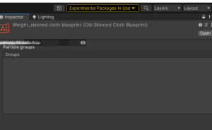

(10-10-2024, 10:43 AM)josemendez Wrote: The solution in that thread's last comment won't solve the issue, will only keep the error from logging to the console. The editor won't work properly, since properties are still null. The proper solution to this bug (caused by Unity improperly managing public members when multiple inspectors are open) is to close all secondary inspectors.
This was circumvented in Obi 7.0, as we use Unity's new Stage API instead which doesn't trigger the error. Hello. I updated from obi 6 to 7 frew days ago, and now i am dealing with setting particles of obi sample trench coat to groups so I can edit their properties' values in the script. And after I added groups and set particles into them I got this UI layout issue again.
As you can see, the ui layout of the obi cloth blueprint is messed again.
and this is part of the script that I wrote to set particles.
Code: coat.ClearParticleGroups();
coat.AppendNewParticleGroup("red");
coat.AppendNewParticleGroup("white");
coat.AppendNewParticleGroup("blue");
as you can see, what I did was just cleaning particle groups, then appending new particle groups in runtime. then I exited playmode, tried to open the blueprint in editor, and got this issue again. I thought it was fixed already in obi 7. Can you tell me what I did wrong?

(17-10-2024, 09:38 AM)gahyun11 Wrote: what I did was just cleaning particle groups, then appending new particle groups in runtime. then I exited playmode
Modifying particle groups at runtime and having them persist once you get back to edit mode is not a supported use case. Our code is explicitly designed to disallow this, look at ObiActorBlueprint.cs InsertParticleGroup and ClearParticleGroups methods: they do completely different things based on the value of UNITY_EDITOR and Application.isPlaying.
There's two reasons for this: one is that Unity's editor API is of course only available in-editor, so doing this in standalone builds is simply impossible since standalone applications can't modify the asset database (there's no editor asset database!).
The other one is that even if technically possible when entering play mode inside the editor, persisting changes involves writing subasset data to disk which is an *extremely slow* operation. Typically, adding new particle groups at runtime means they will also be used at runtime so any operations involving them must be as fast as possible and must not persist outside of play mode.
Unity follows a similar convention on most of its built-in assets. See:
https://docs.unity3d.com/Manual/Modifyin...pting.html
If you want to persistently modify particle groups and have them written to disk as assets, you must modify them using editor scripts, not at runtime.
(17-10-2024, 09:38 AM)gahyun11 Wrote: As you can see, the ui layout of the obi cloth blueprint is messed again.
This is a different error from the one you'd get in Obi 6 due to currentProperty being null due to Unity not correctly initializing public fields in custom editor. The problem here is that particle groups have been added to the a shared blueprint (instead of an instance of it) but have not been persisted to disk. As stated above, this is not supposed to be possible. We'll add an extra check to the editor window in upcoming versions.
Both issues prevent UI rendering from completing successfully, so they manifest in the same way.
