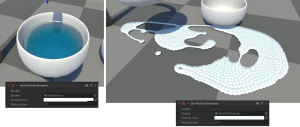

I was wondering whether there is a work around with the shader that the Obi Particle Renderer component uses. I played about with switching between shaders that came with Obi and the ParticleShaderURP has a different result compared to the normal ParticleShader. Attached in an image of what I mean. (left is default ParticleShader, right is ParticleShaderURP)
Is it possible to copy the shader and manipulate it to render a specific emitter particles to be opaque?

Obi 7 (which is currently undergoing beta) allows for this, by using rendering passes. These are scriptable objects that relate specific fluid emitters to specific fluid renderer features. This allows you to have multiple renderer features in URP, each one rendering a specific subset of emitters in the scene. See:
http://obi.virtualmethodstudio.com/forum...-3849.html
http://obi.virtualmethodstudio.com/manua...ering.html
