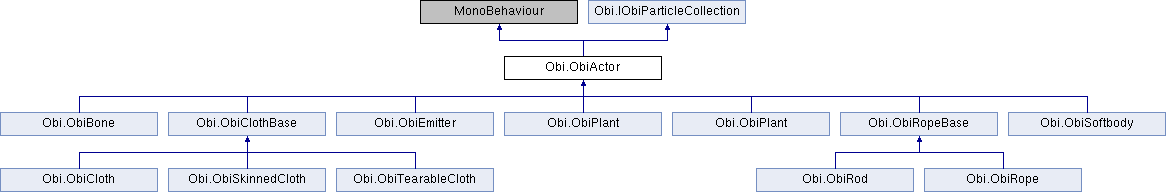

Inheritance diagram for Obi.ObiActor:
Obi.IObiParticleCollection Obi.ObiBone Obi.ObiClothBase Obi.ObiEmitter Obi.ObiPlant Obi.ObiPlant Obi.ObiRopeBase Obi.ObiSoftbody Obi.ObiCloth Obi.ObiSkinnedCloth Obi.ObiTearableCloth Obi.ObiRod Obi.ObiRope
