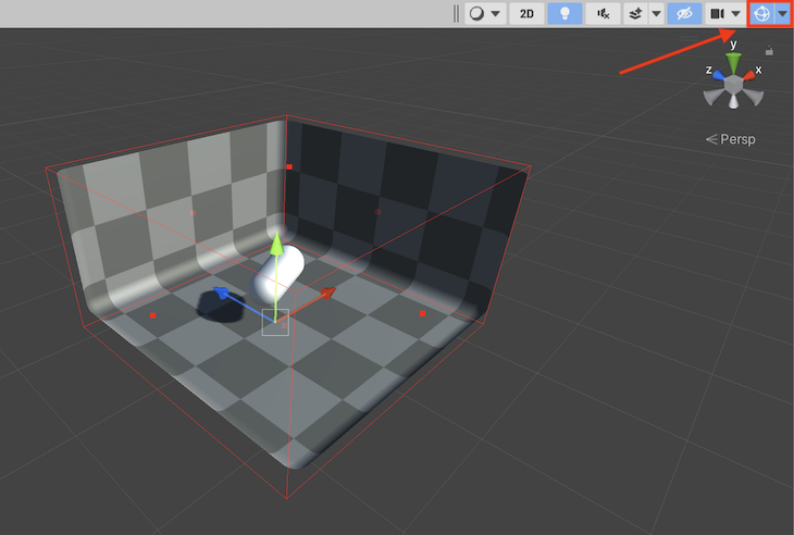

Use limits
By default, the simulation performed by a solver is unbounded: particles can go anywhere. Enabling this checkbox adds box-shaped limits to the solver, that particles cannot leave.
Kill off limits particles
Any particles created by emitters (either fluid or granular) will be killed and returned to their emitter's pool as soon as they touch the solver's limit box.
Boundary limits
Allows you to specify the center and extents of the solver's limits box.
