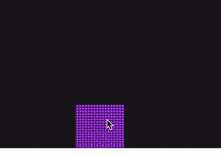

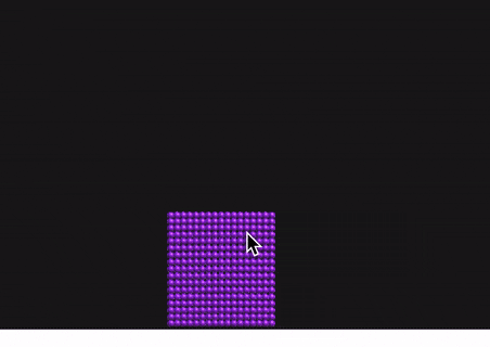

All this right, left, right, left... iterative solving causes visual jittering, as we see the particle jump between two configurations until all collisions are resolved (which can take a very high amount of iterations). For this reason, Obi lets you decide (as it does with all constraint groups) how collisions must be resolved: sequentially or in parallel. In parallel mode, all contacts are resolved independently in the same step (as if the others did not exist) and the final correction is calculated as an average of all their individual results. This increases stablity (removing jittering due to unresolved collisions) but decreases convergence speed (achieving zero-penetration takes more iterations) making collisions seem too "soft" when using low iteration counts. See the next diagram:
General rule of thumb: If multiple collisions can happen at once in your scene and jittering is an issue, set your collision constraints evaluation order to "parallel". If jittering is not a problem and/or you need faster convergence, use "sequential" evaluation order. There are separate controls for particle-particle collisions and particle-collider collisions, so you can use different methods for each of them. You can find this settings in the ObiSolver inspector, under "Particle Collision Constraint Parameters" and "Collision Constraint Parameters":
See ObiSolver for more info on sequential vs parallel solving.
Sequential and parallel contact resolution comparison, using just 3 iterations and medium friction. Jittering has been artifically increased to illustrate the differences better.
