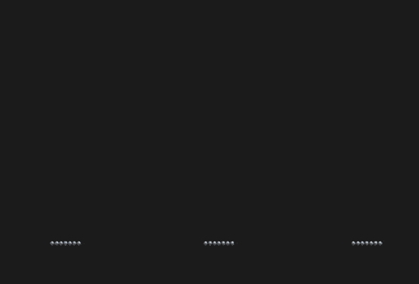

Resolution
Resolutions from left to right: 1,2.5,5
This parameter controls the size and amount of particles used to represent 1 cubic meter -or square meter, in 2D- of fluid volume. The default value (1) will use 1000 particles per cubic meter. Higher values will cause the size of particles to decrease, so that more particles will be neeeded per volume unit.
