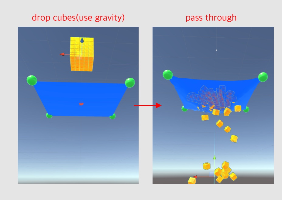

Drop several cubes on the clothes as shown in the picture.
Then some cubes break through the clothes.
Please tell me how not to go through clothes.

Many cubes on top of the cloth will cause the cloth to stretch due to their combined mass. This can open holes in the particle-based representation of the cloth, trough which cubes can pass.
Either reduce the mass of the cubes, increase the mass of the cloth, or increase the amount of substeps (found in the ObiFixedUpdater component) to improve simulation quality and allow the cloth to resist heavier loads. Also, using more collision iterations will help with collision detection quality.
Alternatively, you can use surface collisions to extend collision detection to cloth faces, not just cloth vertices. This will make it harder for small cubes to slip in between particles.

(10-01-2022, 12:47 PM)josemendez Wrote: Hi!
Thank you so much for your kind and detailed explanation.
One more thing, how do I increase the mass of clothes?

(11-01-2022, 01:49 PM)suxxexx Wrote: Thank you so much for your kind and detailed explanation.
Same way you can change any per-particle property: enter the blueprint editor, set the property dropdown to "mass", then select the desired particles and set their mass value. See:
