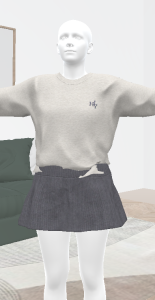

**This is a screen shot of the issue of the t shirts clothing. As you can see, the particles of each clothings - t shirts and skirts - are going through each other. I used stretchscaling and stretchCompliance on both of clothings, and the skirt is enabled first then after few seconds, t shirts is enabled.

(21-10-2024, 03:25 AM)gahyun11 Wrote: **This is a screen shot of the issue of the t shirts clothing. As you can see, the particles of each clothings - t shirts and skirts - are going through each other. I used stretchscaling and stretchCompliance on both of clothings, and the skirt is enabled first then after few seconds, t shirts is enabled.
Use one-sided collisions on both the skirt and the cloth, they rely on self-collisions so that the t-shirt is always over the skirt.

(21-10-2024, 07:56 AM)josemendez Wrote: Use one-sided collisions on both the skirt and the cloth, they rely on self-collisions so that the t-shirt is always over the skirt. I'm sorry but where can I find that? I keep looking skinned cloth blueprint of both clothings and its obiskinnedcloth component but cant find any "one-sided" colliision. I see "Self collisions" on Obi skinned Cloth component but this is not what you are talking about, isnt it? I'm currently using obi 6.5.4 cause we need time to convert all clothings' skinnedclothblueprint from 6.5.4 to version 7.

(21-10-2024, 09:53 AM)gahyun11 Wrote: I'm sorry but where can I find that? I keep looking skinned cloth blueprint of both clothings and its obiskinnedcloth component but cant find any "one-sided" colliision. I see "Self collisions" on Obi skinned Cloth component but this is not what you are talking about, isnt it? I'm currently using obi 6.5.4 cause we need time to convert all clothings' skinnedclothblueprint from 6.5.4 to version 7.
Code: cloth.oneSided = true;
This allows particles to only collide with the side their normal vector is pointing towards. So if another particle tries to collide with its backside, it will be projected to the front.
See the "OneSidedCollisions" sample scene.

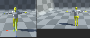

this clothing mesh asset has inside and out side surface. I even changed all property values to particles in torso part, but arm particle and neck particles keep jittering. I also folllowed solver property in body in character cloth sample scene in obi 7

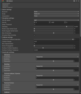

I tried both obi 6 and obi 7.
In obi 6, as you can see screenshots, I used original solver setting that we've used and which is different with sample scene. This solver setting works fine except two sided clothing mesh asset(which has inside and outside like obi trench coat mesh). The result is it doesnt fall but arms and collar part's particles jitter too much.
In obi 7, I just copied man_trenchcoat solver setting but I used distance field. Using distance field did work fine with trench coat but not with clothing asset that we have. The clothing asset has just disappearing as soon as I play. I tried different clothing asset too, which has only one sided mesh clothing asset, and the result was same. I editted double sided mesh clothing asset blueprint like your trench coat, and after i figured out it didnt work well(dissapearing) then I just created skiined cloth bluprint newly just it case and still the clothing assets disaapear as soon as I play.

(23-10-2024, 03:39 AM)gahyun11 Wrote: I tried both obi 6 and obi 7.
Jitter can be caused by multiple problems. Most often, constraint fighting or concave distance fields.
Make sure your cloth isn't smaller than the body's distance fields, and make sure to use multiple convex distance fields instead of a single concave one. This is also the only way to use distance fields with a deformable object such as a skinned mesh, since SDFs cannot deform.
Keep in mind that SDFs store just the closest distance for each point in space, and this closest point may be different each frame in concave areas which leads to jittering.

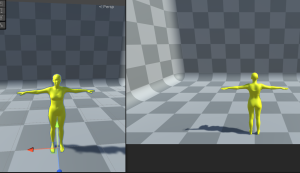

(23-10-2024, 03:39 AM)gahyun11 Wrote: In obi 7, I just copied man_trenchcoat solver setting but I used distance field. Using distance field did work fine with trench coat but not with clothing asset that we have. The clothing asset has just disappearing as soon as I play. I tried different clothing asset too, which has only one sided mesh clothing asset, and the result was same. I editted double sided mesh clothing asset blueprint like your trench coat, and after i figured out it didnt work well(dissapearing) then I just created skiined cloth bluprint newly just it case and still the clothing assets disaapear as soon as I play.
Cloth should not just disappear, I've been unable to reproduce anything like this. Would it be possible to share details about your setup?

Cloth should not just disappear, I've been unable to reproduce anything like this. Would it be possible to share details about your setup? Hello! Thank you for kind explanation. Since we are using distance field created from body shaped mesh, I think cause of the jittering is body shaped mesh.

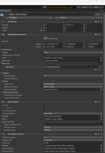

And this is the link of our project file in google drive. I set the environment scene ' Test_CharacterCloth.scene' in Assets/Test directory. and There is a body gameobject named 'female_default_mannequin_trenchCopy'(I know, it is a long name lol) with obi solver and it is wearing cloth gameobject named 'TOP_hly_oatmeal' . As soon as I start play mod, the cloth object disappears in scene...? It still exists in scene but other clothes have same situations.
These are the screenshots
