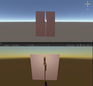

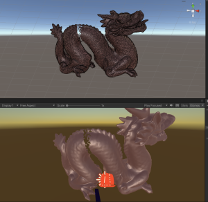

Hello Again,
Thank you, with the information I got from you, I was able to successfully implement the removing triangle on obi softbody . Now I would like to ask another question if it is ok with you.
I want to separate the object in two after I removed all the triangles from middle or while i am removing the triangles it gets separated from the part of removed triangles. Do i need to access particles or what?
P.S; I did not fix the culling that is why the other side of mesh seems empty. I also added the image for the cloth that I am trying now.
You will need to access particles, constraints, or possibly both depending on what you want to do.
Note this is an extremely advanced use case, you will possibly need information beyond what's covered in Obi's manual to get this to work. I'd suggest taking a look at the research articles used to write Obi, you can find a complete list here: http://obi.virtualmethodstudio.com/references.html
