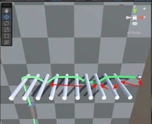

What im trying to do with OBI Rope is a simple weaving mechanics. In which i have rows of cylinders and then I use the rope in this case the wefts to move across and wrap around thos columns back and forth:
Notes
Im using OBI-Rope Version 7
Im using the Cursor to add new segements/Particles at the end of the rope
Main Issuses
  1. When I hit the down or up arrows using rigidbody force to move the rope 1 unit along a clyinder,, the whole rope is affected, But what i want is on ly for the last one or last to segments to be affected by this force and all the previous one should stay where they at. ( Shown at the end of the attched video)
  2. When the rope is moving faster the collision breaks and rope goes through the columns/warps. but if I move it slower it seems to act good which brings us to issue #3
  3. Im building on top of the Wrap-The-Rope  Sample scene, which by default has a tension. I can stop this tension by making the start attchment as Static by then i lose the colliding
My questions are
  • How to control specific segemnts as to freeze their position once created and only move the last n-ones
  • How to have collison not be broken no matter how fast or streched is the rope
  • How to stop/ disable the tension without the comprimising the dyniamic bhaviour of the attched ends

Sorry for the confusion and thanks for your reply.
- 1st I cannot attatch video files due to fromat issue i tried MP4 and other formats. what format are acceptable?
- By tension i meant like pulling-force that in Wrap-a-Rope the Tenser object is pulling the Player object. If i wanted to stop this pulling i make the attachment static, but i noticed that i the colliders doesn't hold any more only for few sec then by pass other objects.
- When i said no matter how fast or stretched mainly i meant on reasonable level as how to control that (I'll try to play with resolution and see). as the intended behaviour is that the rope will act as a thread/weaving:
  • the start attachment will be fixed not moving.
  •  And then through VR controller i move the end attchment across an array of cylinders up and down (Im using the cursor to increase the length here)
  • once i reach the end of the array of cylinders i go back and forth same way until the end of the cylinder length
But the issue as im going through the cylinders theres pulling/force which i need to increase the acceleartion of the player to overcome it
and regarding going next row ill try to make invers mass to zero and see
[attachment=2167]

Ok, so you have a fixed length of thread, statically attached on one end, and you're able to freely move the other end. You weave it past an array of cylinders, and once the rope is completely taut... then what? How do you use the cursor to increase length and allow the user to keep weaving?
(26-08-2024, 04:44 AM)Barax94 Wrote: and regarding going next row ill try to make invers mass to zero and see
Setting particle inverse mass to zero (that is, fixing these particles in place by giving them infinite mass) won't work for an obvious reason: How are you going to keep the rope sliding past the cylinders it's already been woven around? You can't just fix it in place can you? You need the entire rope to be simulated at all times, otherwise it won't be able to slide past the cylinders as you continue weaving.
The way I would approach this is to drive the change in rope length (cursor) using a measure of rope strain: the amount of stretching caused by tension, which is the rate of current length vs length at rest:
float strain = rope.CalculateLength() / rope.restLength;
When strain increases, you increase rope length until strain goes down to a given range. When strain decreases, you reduce rope length until it's back within range. This way the tension in the rope is more or less constant, and it dynamically resizes as you pull it around.
