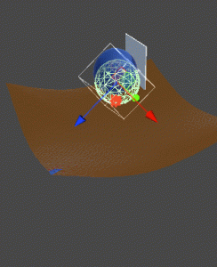

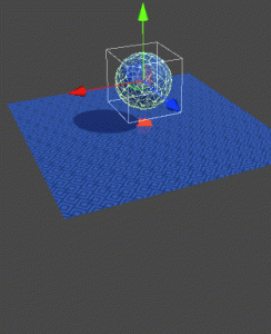

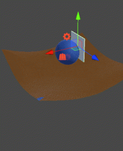

Can softbody be used on cloth? - astest - 02-06-2023
[attachment=1803]
[attachment=1804]
[attachment=1805]
Softbody sphere
I want to drop it on the cloth.
the position of softbody collisions is unstable.
how shall I do it?
gif file will not play click to see.

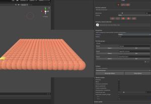

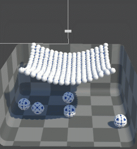

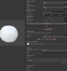

RE: Can softbody be used on cloth? - astest - 08-06-2023
(08-06-2023, 09:09 AM)josemendez Wrote: There's a fundamental misconception here: adding Collider component to cloth or softbody doesn't make any sense and will interfere with the simulation. The reason is that Colliders are designed to work with Unity's Rigidbodies, since they cannot deform.
For the same reason, adding a ObiCollider component is also completely unnecessary. Colliders are designed to make cloth/softbodies react to regular geometry in the scene, such as walls, floors, etc. I'd recommend reading the manual page about collisions:
http://obi.virtualmethodstudio.com/manual/6.3/collisions.html
Obi is a particle-based engine. This means that all aspects of simulation - including collisions- are performed using particles. There's no need to add a Collider to a cloth or softbody for them to collide with other objects, since particles already take care of that. However, you must make sure that the particles in your objects don't have huge gaps in between them (such as the ones seen in your video) since that will allow objects to pass in between particles. The simplest solution is to make your particles bigger, tweaking their radius in the cloth/softbody blueprint editor.
As I told you, I've grown the particles in the particles, but they don't collide
Adjusted to Property-Radius value in Blueprint.
I removed all the colliders and obi colliders.
Isn't it this? T_T
[attachment=1810]
[attachment=1811]
[attachment=1812]
RE: Can softbody be used on cloth? - josemendez - 08-06-2023
(08-06-2023, 10:17 AM)astest Wrote: As I told you, I've grown the particles in the particles, but they don't collide
Isn't it this? T_T
If they don't collide at all, check that:
1.- Both the cloth and the softbody belong to the same solver. Actors in different solvers won't interact with each other in any way, since they're part of different simulations. See:
http://obi.virtualmethodstudio.com/manual/6.3/obisolver.html
Quote:Each solver is completely independent from other solvers. Therefore, actors being updated by different solver won't interact / collide with each other. Only actors in the same solver will react to each other.
Just realized that in your video you seem to have 2 separate solvers, one for the cloth and another one for the softbodies. This will ensure they are simulated separately and don't know about each other's existence.
2.- Particle collisions are globally enabled in the ObiSolver component, under the "constraints" foldout.
3.- Collision filters are properly set up for both the cloth and softbody (that is, they're not set to ignore each other's category). See:
4.- The mass of the cloth and the softbody particles are comparable, you can check this in the blueprint editor. If the softbody is much heavier than the cloth, it will push it out of the way and end up passing trough it.
RE: Can softbody be used on cloth? - astest - 09-06-2023
(08-06-2023, 10:57 AM)josemendez Wrote: If they don't collide at all, check that:
Thank you very much!!! It's working fine.
