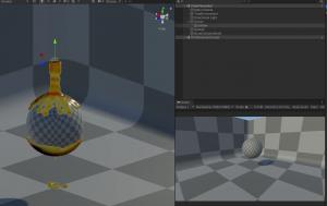

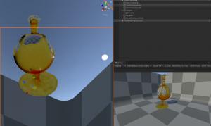

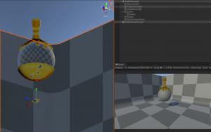

1) annoying but minor.
In the editor, in execution, I have side by side the display of the scene and the display of the game. Depending on the position of the display on the stage side, the fluid is not displayed on the game side. At first I thought it was zooming, moving away the fluid was displayed on the game side, but after several manipulations it actually depends on the display of the plane that serves as the ground! See images cas1_[1/2/3]: I just have to turn the display to see the ground from below and the display becomes ok on the game side. The hidden area on the game side seems to correspond exactly to the display area on the floor on the stage side. If i just desactivate the mesh renderer of "TestEnvironnement" the fluid is ok in game side...

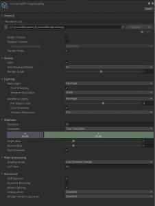

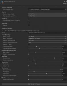

I add in PJ the rendering configuration.

Your URP pipeline has both depth and opaque textures turned off. This means the fluid won't be depth-sorted correctly with other objects in your scene (might even disappear completely) and refraction won't work properly either.
You must enable both, as explained in the manual as well as the URP setup video:
http://obi.virtualmethodstudio.com/manual/6.3/fluidrendering.html
https://www.youtube.com/watch?v=k5Uv5ecjVM0&list=PLnCR8_XCOgrbhhk40Bxbw8gcnaiy5PYL_
Quote:except on the Emitter replacing the shader by Obi/URP/Particles since I am in URP (in fact this change nothing...)
This won't have any effect because you're not rendering particles, but the fluid surface.
