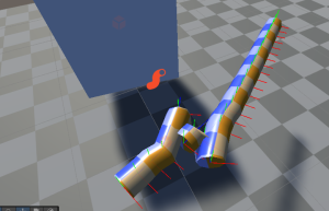

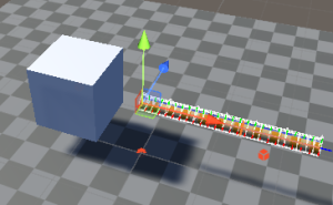

Hi, when rod is attached in dynamic mode and constraint orientation is enabled, then the whole attachment becomes broken. To be precise the orientation taken into account is flipped and rod tries to keep opposite direction. This bug can be sometimes not obvious, because when rod is rotated it gets apparent stability for short time.
To reproduce, simply create box with rigidbody (can be frozen and kinematic for particles for better result) and create dynamic attachment with constrained orientation.
I want to not that it's best if box and rod is perfectly aligned and not rotated.
Attached image shows my setup before and several frames after starting simulation.
Obi 7.1
Unity 6000.0.54
(08-08-2025, 06:07 PM)Qriva0 Wrote: Hi, when rod is attached in dynamic mode and constraint orientation is enabled, then the whole attachment becomes broken. To be precise the orientation taken into account is flipped and rod tries to keep opposite direction. This bug can be sometimes not obvious, because when rod is rotated it gets apparent stability for short time.

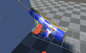

The workaround does not work, it makes rod wiggle like crazy, then randomly stops for a moment when it becomes more stable for several seconds (see attached image).
I think dynamic attachment calculates quaternions/matrices incorrectly, because static attachment works correctly (custom script as well).
