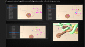

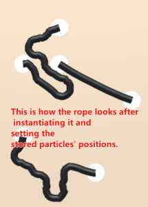

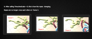

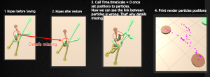

But now I have encountered some new problems. I have uploaded the latest results and problem pictures in the attachment.
Following your advice, I have now saved the length and position of the particles, as well as the ControlPoints in the blueprint, while inTangent and outTangent are Vector.zero, so I didn't save it in order to save space. When instantiating the rope, the originally stored controlPoints are restored through the blueprint's AddControlPoints() method, and after the blueprint is fully loaded, the stored positions are reset to the particles, which allows for the restoration of the shape of the rope for the vast majority of the time as it was before it was saved. So now the generated rope is really similar to what it was before it was saved. But there is still some loss of detail, which directly affects the difficulty of the game in the actual gameplay.

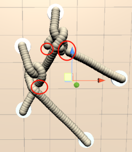

The images in the attachment should sufficiently illustrate the situation of the problem. Here, I will provide a brief description as well, just in case the images cannot be viewed: After the restoration, the shape of the rope is really close to it was saved. However, some areas where the ropes are twisted with each other are lost, regardless of the complexity of the twists. As can be seen in image 6, even simple windings can sometimes be lost, even though they had clearly occurred by the first frame.
From image 5, it can be observed that the particles extracted from rope.solverIndices are not contiguous in position, which I believe to be normal according to the Obi documentation. However, I am not certain if this is the cause of the loss of detail.
可以看到从rope.solverIndices中取出的particle,在位置上并不是连续在一起的,根据obi的资料后,我觉得这应该是正常的。但是不确定是否这是导致细节丢失的原因。
The order of the particles in rope.elements is coherent. I have tried to save and restore these particles, but the problem persists.
