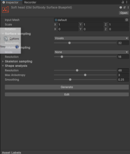

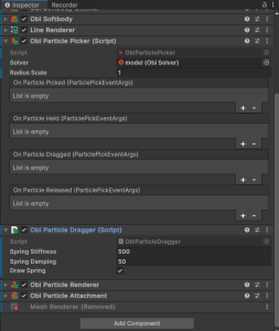

I'm using the particle dragger on a softbody, but i doesn't drag on the exact area i click on the model, it drags somewhere else on the softbody, these are the screenshots of the softbody setup.

Keep in mind that the particle dragger acts as a spring: it will drag the particle along the mouse cursor using a spring force (similar to Unity's distance joint), it won't just position the particle directly under the cursor every frame. If you're looking for a stiffer spring, you can adjust the spring's stiffness and damping parameters in the ObiParticleDragger component. Or if you're not looking for a spring-based solution at all, you can write your own component that sets the particle positions directly using the particles API.
