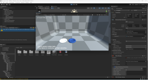

hello!
I have two questions regarding soft bodies.
The first one,
The BallPool in the sample scene is set to a blue ball component,
Press the Generator only once on “RubberBall” of “epaintr”,
Press “Bind Skin” of “Softbody Skinner” only once
No other buttons are pressed.
When I play the game, it gets crushed as shown in the image.
And if you fire several balls, the processing becomes heavy.
If I play the sample as is, it works fine.
I'm curious about the error shown in the image, but I can't figure it out.
Please let me know if you have a solution.

Looks to me like your blueprint resolution is way too high, which results in a lot of particles being created to represent the softbody, leading to poor performance and too fine a surface.
Add a ObiParticleRenderer component to your softbody and check how particles look at runtime, compare to how they look for the included/default scene. Lower your blueprint resolution, re-generate the blueprint and re-bind the skin. That should fix it.

Thank you for your response.
I was able to understand the resolution and solve it.
