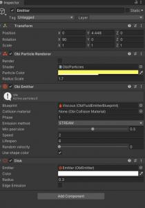

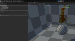

(19-04-2021, 04:41 AM)LiegeOfAnima Wrote: My installation: 2019.4.15f1, URP, Obi Fluid 4
Hi there!
What Obi version are you using? 4 is a really old one.. judging from the screenshots, you're using 6.0 or 6.0.1.
I can send you the patch if you let me know your email. You can write to support(at)virtualmethodstudio.com and I'll send it to you.
Note this bug only affects the fallback backend (Oni). Using the default backend -Burst, which is recommended- does not trigger this issue. Your solver settings show you're using Burst, but the engine is falling back to Oni because you don't have the required dependencies installed as the warning message in the inspector shows.

(19-04-2021, 07:36 AM)josemendez Wrote: Hi there!
Note this bug only affects the fallback backend (Oni). Using the default backend -Burst, which is recommended- does not trigger this issue. Your solver settings show you're using Burst, but the engine is falling back to Oni because you don't have the required dependencies installed as the warning message in the inspector shows. (What Obi version are you using? 4 is a really old one.. judging from the screenshots, you're using 6.0 or 6.0.1.)
Thank you for the prompt response! you're right about the version being 6.0-6.0.1, my mistake.
(Note this bug only affects the fallback backend (Oni). ...Your solver settings show you're using Burst, but the engine is falling back to Oni because you don't have the required dependencies installed as the warning message in the inspector shows.)
Here's the thing, that warning message is no longer there because I didn't include the collection. (I don't know how I missed that.) so for those who struggles to get collection to installed, here is the link:
https://forum.unity.com/threads/cant-fin...ge.925478/
This wasn't exactly my intention to waste anyone time with this, I'm learning the ropes. but I'm still grateful for the assistance!
