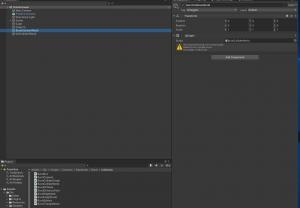

I noticed that most of the sample scenes having these 2 warnings.
(The referenced script (Obi.BurstColliderWorld) on this Behaviour is missing!)
(The referenced script on this Behaviour (Game Object 'BurstCollisionWorld') is missing!)
My best guess is that this issue kinda cause weird color to the emitter particles
Please let me know if there's a way to solve this issue.
Thanks

Sounds like a installation issue. Did you have a previous Obi version installed, or do you have multiple Obi assets installed in your project? Also, did you install the Burst dependencies? (see:http://obi.virtualmethodstudio.com/tutorials/backends.html)
The editor is complaining that the Obi.BurstColliderWorld class is missing, but it is defined in the /Obi/Scripts/Common/Backends/Burst/Collisions/BurstColliderWorld.cs file, and if the required dependencies are installed, it should be compiled. Can you check that?
Regarding the particle colors, I'm unable to reproduce this look, but I doubt missing Burst dependencies are the reason for it. What render pipeline are you using?

I mean the dependencies listed on the manual:
http://obi.virtualmethodstudio.com/tutor...kends.html
Quote:Using the Burst backend requires having the following Unity packages installed:
Burst 1.3.3 or newer
Collections 0.8.0-preview 5 or newer
Mathematics 1.0.1 or newer
Jobs 0.2.9-preview.15 or newer
Without these packages installed, Burst won't run at all, and some of its components (such as BurstColliderWorld) won't even be compiled. All sample scenes use the Burst backend by default. The simulation will fallback to the native backend instead.

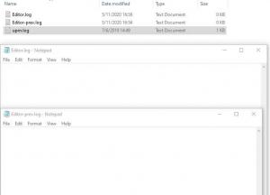

" We can't reproduce any freezes when using the Burst backend, could you share the contents of the editor log?. "
The Editor log doesn't record anything because it is not a Unity engine crash, but just not responding.
The editor logs should contain everything logged since the Unity editor was opened, up to the point where it stopped responding. That's what I'm interested in. Only the player logs will be empty.

" The editor logs should contain everything logged since the Unity editor was opened, up to the point where it stopped responding. That's what I'm interested in. Only the player logs will be empty."
Alright, I managed to find another Unity Editor log, and I hope this is the one that you're looking for.
