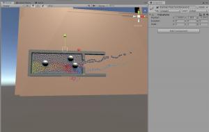

I'll add a few screenshots to explain it.
I used the Karman Fluid Sample-Scene as an example. It was copied to another scene and moved there.
As soon as I move the Emitter on the Z-Axis the Colliders don't work anymore.
The Particle system from the sample scene also just works in the coordinate origin.
Here is the Emitter in its original position:
Here I moved it up on the Y-Axis a bit. It seems like there is a window in which the Particle system works.
Here I moved it on the Z-Axis. No Collisions, no particle system.

If you move the emitter on the Z axis, collisions stop working because the particles stop touching the colliders (they're 3D spheres and boxes, so they have a limited span in all 3 axis). This is how it's supposed to work, of course. Maybe if you rotate the camera the cause will be apparent:
Also, the advected particles (the colored ones, a standard Unity particle system) can only be advected if they're close to a fluid particles. So if you take the fluid emitter away, they will stop being advected and stay in place, like in your last 2 screenshots. Again this is the correct and expected behavior. See:
