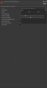

every time i try to create a new ObiSoftbodyBlueprint surface or ObiSoftbodyBlueprint volume i get the following errors in my console:
Instance of ObiMeshBasedActorBlueprintEditor couldn't be created. The script class needs to derive from ScriptableObject and be placed in the Assets/Editor folder.
UnityEngine.GUIUtility  rocessEvent(Int32, IntPtr)
Therefore I am not able to use the editor for the blueprint as shown in the documentation (I can't even press 'Generate' for my mesh).

Can't reproduce here, but a quick search reveals it seems to be a bug in Unity:
https://forum.unity.com/threads/custom-e...ug.579088/
https://forum.unity.com/threads/the-scri...ct.650857/
Even the "Multi-object editing not supported" message appears in your screenshot despite having only one object selected, which is indicative of the bug.
Seems to fix itself by restarting the Editor.
