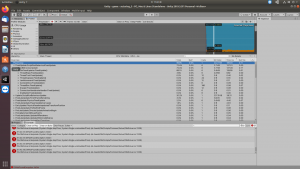

Hi! We are experiencing the Dll not found execption in the linux editor and linux build (again), but this time, everything works, but the performance is way worse than on windows.
The issue is: In windows we are getting 60+ fps all the time (around 80) and on a very similar machine, (same CPU) we are getting less than 30.
I'm not sure exactly what is causing this, if you could help us figure out the issue this would be amazing!
Here's the details:
unity version: 2019.3.7f1
Obi version: the one you sent us by mail (5.1?)
Linux distribution used in the editor: ubuntu 18.04 LTS
Linux distribution used in production (build): Debian 8
number of particles used: 810 (2 softbodies)
substep: 1
constraints iterations: Collision, shape matching and pin: 3 everything else disabled
Fixed Timestep: 0.02
Maximum allowed Timestep: 0.1

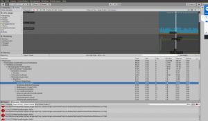

While profiling on windows we had an Obi (fixed update) of 2.15 ms which is great and fits perfetcly what we allowed in terms of CPU time for the softbody;
But in linux it's another story, we are getting around 117 ms for it; here are some screenshots of the profiler in linux:
Overview:
Other observation: Commenting out interpolation from the update method in  solves the issue, but softbody stops reacting (obisolver.cs:1339)
Second post for more screenshots:
ObiUpdater.EndStep()
ObiUpdater.BeginStep()
ObiUpdater.Substep()
thanks in advance!

This alone does not justify such large performance drops as the one originally reported (2 ms - 117 ms) so the only cause I can think of is death spiraling. In the OP's profiler pics, it is clearly visible that FixedUpdate is being called 6 times per frame. That alone will cause performance to be 6 times slower, as physics should only be updated once per frame under normal circumstances. Increasing Unity's fixed timestep or decreasing the max fixed timestep would enable the simulation to recover and perform normally.
It was recorded with deep profiling enabled so this might be the reason for the death spiraling, thanks for the input!.
With real-world tests, on our production machine we get 40-50 fps (same particle count and parameters as before, debian).
But on windows with a slightly faster machine we get 350+ fps (on the same machine but ubuntu around 300).
So it might just be that the production machine is just slow enough to reach the death spiraling threshold... but seems weird that it "stops" at 50, I would expect worse results. (setting the max fixed timestepdid not help in the production test)
