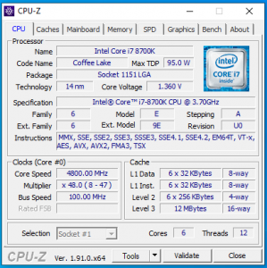

After careful testing we've determined it to be a bug in the math library we use, Eigen:
https://eigen.tuxfamily.org/bz/show_bug.cgi?id=1233
Seems to only affect 64 bit Linux. It is caused by an unaligned memory read during matrix data assignment. Weirdly enough we've not been able to reproduce it.
Does your CPU support simd extensions, specifically SSE2 and/or AVX?

Thanks for the quick support! According to CPU-Z yes

(20-12-2019, 09:33 AM) Emmaa Wrote: Thanks for the quick support! According to CPU-Z yes
Are you virtualizing the OS, or is it installed in the host device directly? (Just asking because CPU-Z only runs in Windows/Android afaik, so that we can reproduce the conditions as closely as possible).
Also, what Linux distro are you running?

(20-12-2019, 09:54 AM) josemendez Wrote: Are you virtualizing the OS, or is it installed in the host device directly? (Just asking because CPU-Z only runs in Windows/Android afaik, so that we can reproduce the conditions as closely as possible).
Installed directly, I'm using the unity editor in windows 10 (obi 5.0 unity 2019.17f). Then building for linux 64 bits and testing it on Ubuntu 18.04.3 LTS (same computer/cpu, 2 partitions)
