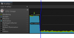

I reduced the max particle count to 600 for the solver but this did not have any notable effect. Used particle count is 165 (noticed this information inside the Solver's inspector.
Sometimes ObiSolver.LateUpdate() and ObiSolver.FixedUpdate() taken up roughly the same amount of time (4ms each) but most of the time LateUpdate() takes around 6ms and FixedUpdate() 2ms.
What should the ms stay at? Doesn't this depend on little bit on the hardware? CPU is 7700HQ and GPU GTX 1070, if that helps. And these measurements are taken from inside the Editor. Perhaps the calculation time is reduced in a build.
How many constraint iterations/solver substeps are you using? 4-7 ms for a bit over a hundred particles is not normal. Should be below half a millisecond in-editor. Depends a bit on the hardware, but with a quad-core CPU it should be even faster.
Edit: I assume you're not using deep profiling?

(10-12-2019, 12:28 PM)josemendez Wrote: Hi,
I am not using deep profiling.
An example frame:
Editor loop takes 46.1% of calculations, 2 calls and 8.35 ms. Profiler takes 3% and 0.55 ms.
PlayerLoop in total takes 50.6% and 9.15 ms.
ObiSolver.LateUpdate() takes 21.1% and 3.88 ms.
FixedUpdate.ScriptRunBehaviour takes 6.8% and 1.24ms. 5.9% of 6.8% and 1.09 of 1.24 ms of this is ObiSolver.FixedUpdate().
These two are also the highest performance demanding operation.
Next is FixedUpdate.PhysicsFixedUpdate with 4.7% and 0.87 ms. This has quite a lot of sub calculations with the maximum taking 0.6% (0.11 ms).
Then comes Camera.Render with 3.8% and 0.69 ms.
Substeps property of the solver is set to 1. Every constraint calculation in the solver is active and for each constraint solver the Iteration count is 3 and relaxation is 1.
Sequential evaluation: Distance, Particle Collision, Collision, Skin, Stretch Shear Bend Twist, Chain
Parallel evaluation: Bending, Particle Friction, Friction, Volume, Shape Matching, Tether, Pin, Stitch, Density.
All rods use the following constraints: Stretch Shear, Bend Twist, Chain, Tether, Pin (there is 1-2 pins for each rod).
All ropes use the following constraints: Distance, Bending, Tether, Pin (1-2 pins for each rod).
There are 4 rods and 2 ropes.
Using Unity 2019.1.14f1.

(10-12-2019, 01:16 PM)Wattosan Wrote: Hi,
An example frame:
Ok, so the simulation takes 1.2 ms (ObiSolver.FixedUpdate) and rendering (ObiSolver.LateUpdate) 3.8 ms, right? (FixedUpdate.PhysicsFixedUpdate is Unity's physics)
That could be within normal ranges, I was under the impression that simulation alone was taking 4-7 ms.
I assume you're using the default Extruded renderer for the ropes, correct? Are you using smoothing?

(10-12-2019, 01:37 PM)josemendez Wrote: Ok, so the simulation takes 1.2 ms (ObiSolver.FixedUpdate) and rendering (ObiSolver.LateUpdate) 3.8 ms, right? (FixedUpdate.PhysicsFixedUpdate is Unity's physics)
Yes, currently the ObiSolver.FixedUpdate() seems to remain between 1.2-2.5ms. LateUpdate() between 3.5-6.0 ms.
I am using the Rope Extruded Renderer for both the rods and the ropes. Smoothing for rods and ropes is set to 1.
EDIT: Okay, reducing the smoothing to 0, it is now 3 times faster. It takes around 1-2 ms for the LateUpdate() now.

(10-12-2019, 02:00 PM)Wattosan Wrote: Yes, currently the ObiSolver.FixedUpdate() seems to remain between 1.2-2.5ms. LateUpdate() between 3.5-6.0 ms.
Smoothing increases the amount of rope sections that have to be processed and rendered. So by decreasing it, rendering becomes cheaper.
You could also use a rope section with less segments (the default one uses 8), so that each rope section is also cheaper to compute. Maybe you can get away with 5 or even 3 segments.
