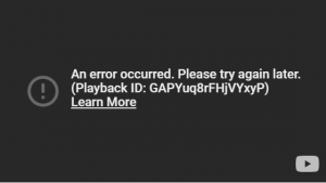

We're unable to reproduce this. Same Unity and Obi versions.
When editing particles in prefab mode, all edit operations are correctly performed. See this video:

Sorry, I can't see the video
Thank you.
