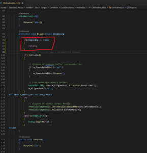

I checked the error code and found strange parts.
The Dispose process used Bool, but it was not actually used in the Function
Therefore, I added a correction, but I am not sure if this correction is correct.
After more digging . I think Obi's implementation of Create and Dispose may have missed implementations, resulting in Dispose not running properly.
If anyone is also investigating, welcome to join

I'm unable to reproduce the issue on Unity 2022.3, however I could reproduce it in 2023.1. Seems like the ObiNativeList constructor is not being called by Unity when deserializing it in the editor, but the safety handle is destroyed in Dispose() regardless.
Move the atomic safety handle release inside the if (isCreated){} conditional, like so:
Code: protected void Dispose(bool disposing)
if (isCreated)
// dispose of compuse buffer representation:
if (m_ComputeBuffer != null)
m_ComputeBuffer.Dispose();
// free unmanaged memory buffer:
UnsafeUtility.Free(m_AlignedPtr, Allocator.Persistent);
m_AlignedPtr = null;
#if ENABLE_UNITY_COLLECTIONS_CHECKS
try
// dispose of atomic safety handle:
AtomicSafetyHandle.CheckDeallocateAndThrow(m_SafetyHandle);
AtomicSafetyHandle.Release(m_SafetyHandle);
catch (Exception ex)
Debug.LogError(ex);
#endif
This ensures that the safety handle is only attempted to be destroyed if the array has had its constructor called and m_AlignedPtr is not null.
let me know how it goes,
kind regards

Thanks response.
There is a section I would like to add regarding the issue of memory leak that was just mentioned
In the base Class of the original abstract type, there are two Constructors.
The object inheriting this Class is being implemented, and it seems that not two implementation types are being used.
Therefore, when using isCreated as a judgment, such as the Int type List in the image below, there may be memory leaks due to incorrect constructor and not call ChangeCapacity at all, resulting in isCreated not being judged as true.
By the way here is a simple way to check memory is leak or not
The above is my current interpretation. If there are any inaccuracies, please let me know
Is it possible for the above issues to exist in the Obi system Flow?
