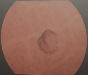

My main soft-body object is a stomach. I created little sphere colliders in the place of obi particles. Then, I shoot a ray from my pulling device and find the picked particles. I assign these particle indices to my pulling device as a particle attachment group and prevent the other particles' movement(basically, I create another particle attachment and specify the particle group to a static position). When I do that, I have this mesh deformation problem. I see triangles and it doesn't look smooth. Here is an example picture:

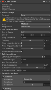

Before you comment, I'd like to say that I've tried various techniques. I played all the parameters(Obi Softbody Skinner, Obi Solver, Shape matching constraints), tested different blueprint resolutions, and finally, tested with different mesh vertex counts. I also tried a combination of these solution techniques. But, the result was always similar to the picture.

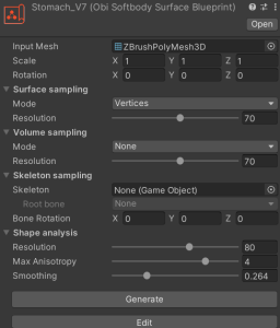

Softbody Skinner
Softbody Influence:0.7
Max Bones Per Vertex:28
Skinning Falloff:0.8
Skinning Max Distance:0.22

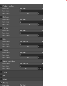

Shape Matching Constraints
Deformation resistance:0.207
Max Deformation:0.875
Plastic Yield: 100
Plastic Creep: 100
Plastic Recovery:500

Softbody Skinner
Plastic Yield: 100
Plastic Creep: 100
