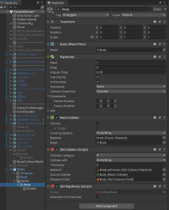

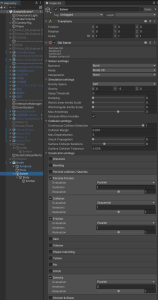

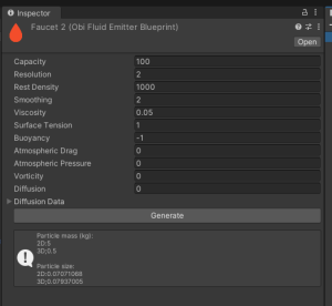

I refer to the settings of the WhiskeyBottle Scene to make a Bottle, how to set it so that the liquid stays in the Bottle
my settings are attached

Hi, I found the problem
Because the model I downloaded only has positive normals and no anti-normals, so the liquid inside will disperse
(21-05-2023, 12:01 PM)jeffLin Wrote: Hi, I found the problem
Glad you found the culprit! Models need to have some cavity inside to hold the liquid, if they're completely solid they can't contain any fluid.
