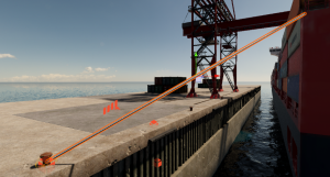

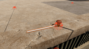

I'm trying to develop a simulation of a ship mooring line breaking and snapping back. So far I've been able to get the rope to tear at one end programmatically, and it looks pretty good, but there are a few problems I'd like to solve:
1. How does one increase the speed the rope flings back after being broken? I would assume it's tied to the tension, but I'm not 100% sure how to increase the tension without shrinking the rope (see below), which is what I saw suggested on another forum post here. Ideally I'd like a different way of doing this.
2. After breaking the rope, it seemingly gets a lot smaller than its original size. See the images attached. In the custom script I wrote, I use a Cursor to reduce the size of the rope at the start so that the tension is increased. However, after breaking, it seems to get much smaller than what I set it to. Ideally I would like the rope to maintain its original length after being broken, so it could fling back and potentially reach its full length in the opposite direction.
