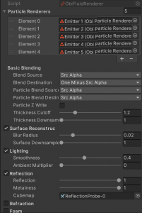

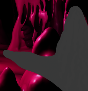

After spending a good amount of time adjusting the fluid parameters in the editor until getting the look I liked, I tried to make a build and was surprised to get a pretty different result. Here are pictures of the editor (left) and the build (right):
I also tried to make a build of one of the examples provided, and I seem to be getting a similar result, where the fluid in the build looks whitened.

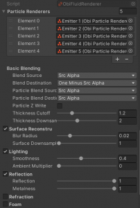

I'm using Windows 10, the Build In Render Pipeline, the ParticleShader in the emitter, and I've tested in both Unity 2021.3.8f1 and 2021.3.9f1 Here are the fluid renderer settings I'm using in my scene:
Thanks in advance!

Obi uses Unity's built-in reflection probes for reflections. Recent Unity versions seem to have a bug that sometimes cause reflection probes to not be available after rendering the skybox, only in builds. See this related thread:
http://obi.virtualmethodstudio.com/forum...-3564.html
The absence of reflections will cause the fluid to look different in build than in-editor. Only seems to be reproducible on certain specific GPUs, and only in 2021 and up. I've already reported this as a bug to Unity.
For the time being I'm preparing an alternate fluid shader that accepts a specific cubemap as input for reflections. Will make it available for download here asap.

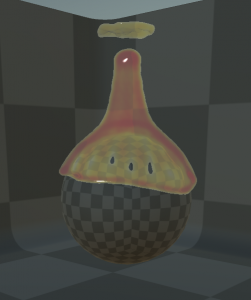

Got it, thank you for clarifying that. After replacing the files with the patched version on the link and after adding the cubemap to the FluidRenderer component, I'm getting a different result than before on the build but still not the same as in the editor.
Editor left, build right:

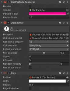

Do you know what might be causing that difference? Here are the emitter and fluid settings:
Thanks!

- What platform are you building for? Does it support floating point render buffers?

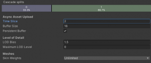

- Are your quality settings the same for both build and editor?
- How have you created the reflection cubemap? I take it is not a realtime probe cubemap (since the original bug is that these stop being available in the build?)

- Yes they are the same, the one the editor uses is the one selected from the list of quality levels right? These are the quality settings I'm using:
