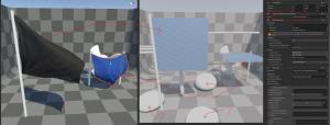

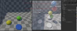

I'm using Octane paid version however you can just as easily reproduce this with the free version of Octane Render from the Unity Asset Store.
Simply install Octane Free version and add a PBR render target to the sample scene. The press render and next hit play.
In the screenshots below I've shown the game window on the left and the Octane rendered version on the right. (I would have attached higher res screenshots but your 100K file size limit prevents me)
I've tried reaching out to Octane customer support but their response was that they cannot support the particle render methods which OBI use.
Which if you look at it from their point of view I do understand. It would not be feasible for them to try to support every asset on the asset store
Their response is below copied verbatim:
Quote:Taking a look into the plugins, it appears that they do not use standard Unity geometry (the Obi rope specifically uses a unique type of particle to achieve it's end result).
It is worth noting that Unity is primarily designed to work with native Unity elements, as well as widely used external elements (i.e. fbx, obj, etc). Certain things, such as billboards. UI elements, and particles, cannot be rendered with OctaneRender.
Third Party/Custom made elements may or may not work with Octane - unfortunately it would not be feasible for us to account for all cases of third-party mesh/material/shader types beyond the well-known and widely used, though some who manage to stay sufficiently close to native Unity implementation may innately work (one example was "SpeedTree") - even in those cases we cannot assure ongoing support for positive cases, as their development roadmaps and workflow are beyond our control.
Making changes and improvements to improve upon these third-party limitations may still be possible to implement on our end, but these may require extensive refactoring or at least a long investigation period. We are always open to feedback, and may consider making a focused efforts into certain third party cases based on popular demand.
Would it be possible to build support for Octane. The reason I ask is because Unity HDRP path tracing which although it is a decent ray tracer does not have a denoiser and unless you flood every scene with full lighting from all directions it is not possible to get decent renders out of it. Which means for the short film production path using Unity Octane is pretty much the only choice.
From this point of view what I'm looking for is: Do your plugins have a hook / method where we can extract the final geometry and spin up a custom mesh based on that instead of the particle render. I know this is expensive but the animation pipeline does NOT need realtime. As a matter of fact rendering one frame in Octane can easily take a minute or two so the overhead of custom mesh generation is really not a big deal.
Except for ObiFluid -which uses screen space ellipsoid splatting-, all Obi assets use standard Unity geometry for rendering. No "particle rendering" methods are used whatsoever, not for ropes, not for cloth, not for softbodies. For all I know, it should work with Octane out of the box since nothing weird or out of the ordinary is being done under the hood. It's all standard Unity stuff.
Quote:Do your plugins have a hook / method where we can extract the final geometry and spin up a custom mesh based on that instead of the particle render.
Simply grab the mesh directly from the MeshRenderer component. There's no other output being generated.
Quote:You do not seem to be using a particle renderer. The response from Octane support seems to be just a fob off cause they maybe can't be bothered producing a complete product for Unity.
Am I reading this right ? based on the following code you are merely modifying a standard mesh at runtime.
Correct. All Obi does is move the vertices of a standard mesh around.
Based on your finding that unless a mesh its saved as an asset it won't render, my guess is that Octane takes mesh assets and performs some sort of pre-process on them to be able to render them (local BVH or some other sort of acceleration structure?). If a mesh is altered at runtime in some way, these changes won't be picked up. Seems to be the case since they mention billboards and particles aren't supported by Octane. This is very limiting as it excludes any form of procedural geometry from working.
I'd ask them again if this assumption is correct and if so, maybe they can provide any alternative that allows for dynamic geometry to be rendered.
