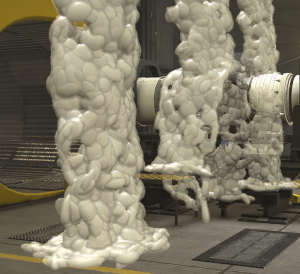

I'm working on creating an effect where sudsy white foam pours down from the ceiling to the floor.  Here's a look at what I've got so far:
It's pretty close to what I'm after, but there are a couple of things yet I need to be able to control:
  1. The total number of particles per emitter seems to be restricted to 1000, making it problematic for the foam to pour down continuously rather than in bursts.
  2. I'd also like to be able to adjust the shininess of the liquid renderer.  The Obi Fluid Renderer doesn't seem to do anything--I can remove it entirely, and everything stays the same.

One more issue:  The particles are rendered with hard outlines, like so:
In order to soften those (as seen in the video in my original post) I rendered the particles with a separate camera, to a RenderTexture, and then layered that over the scene with an blur effect in a shader I made.  Unfortunately, using that technique means the foam is rendered without regard for other objects in the scene, as you can see above.  So, is there any way to blur/soften/reduce those hard edges?

(17-07-2024, 09:40 PM)Barliesque Wrote: In order to soften those (as seen in the video in my original post) I rendered the particles with a separate camera, to a RenderTexture, and then layered that over the scene with an blur effect in a shader I made.  Unfortunately, using that technique means the foam is rendered without regard for other objects in the scene, as you can see above.  So, is there any way to blur/soften/reduce those hard edges?
This is what the fluid renderer does, essentially. However it blurs the particles' depth, then it shades it after the blur: this allows the fluid to correctly intersect with other objects in the scene. You seem to be blurring the final shaded particles, which will cause problems with intersections.
Maybe you could set the fluid renderer transparency setting down, so that it's opaque? See the "Raclette" sample scene settings for reference.
