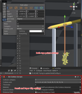

That's how I setup the ObiRope.
And here is the paper clip and pencil setup.

I did that way:
Scene environment colliders - group 1 and don't have any collision mask
Pencil and Paper Clip - group 2 and have collision mask to group 15 (rope). I also tried to set to everything, but it didn't help.
Rope - group 15 and have collision mask to group 2 (pencil and paper clip)
but.. even if this will work as expected without jittering, I see another problem here - when rope falls onto pencil or paperclip, it will go through their physics colliders..
And the conclusion to all my tests - even combining 2 approaches - avoid rope point intersection with pencil/paperclip colliders and settings up the collision group and masks I still have this issue. Seems the problem is somewhere else
