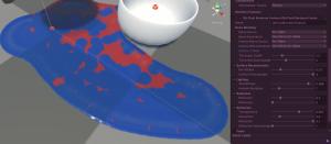

I have 2 different emitters emitting the same kind of fluid: same blueprint, size, etc. Only the color is changed for clarity.
When the 2 fluids come in contact with each others, a visible transparent seam will appear between them.
I am on URP.
Here attached, you can see the seam and the Obi Fluid Renderer settings.
As shown in one screenshot, turning off Particle Z Write removes the seam, but the particles become very blob-ish where they contact each others (from different emitters) and one emitter fluid seems to prevail over the other, giving a wrong impression of what the actual fluid composition should be (looks like 80% blue, instead of the 50% blue and 50% red)
Any idea how to fix this? Changing the color blending (Obi Fluid Renderer) doesn't seem to help, but I don't understand yet what I'm doing there anyway.

Hi there!,
Particle Z Write should be disabled by default: this will prevent other fluid particles from merging with the ones already in the screen by writing to the buffer which is required for some opaque fluid effects, but for the majority of transparent fluid it should be off.
(23-01-2023, 10:28 AM)Voolg Wrote: Any idea how to fix this? Changing the color blending (Obi Fluid Renderer) doesn't seem to help, but I don't understand yet what I'm doing there anyway.
Depending on the colors you're using, and your color blending mode, results will be different. For instance if you're using the default blending which is multiplicative blending, and red / blue as your fluid colors, it will result in black areas where both meet (since red (1,0,0)  x blue (0,1,0) = (0,0,0)).
Right now you seem to be using alpha blending (src_alpha and one_minus_src_alpha as blend factors for both particles and fluid), which will make sure whatever particles are rendered last have preference over those that are "behind" them, using their density as the alpha value.
