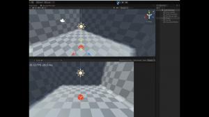

I just bought the asset and it looks great.
However, the scene "Cloth soft body" seems that it has some problems.
The ball are invisible and but the parent solver shape changes when scene starts.
I am using unity 2019.4.8f1 LTS. I trial the package at 2020.1.3f1 as well
Please advise how to fix it.

We're unable to reproduce this. The shape-changing bounding box indicates that the simulation is running correctly, but the assets required for rendering are probably missing from the scene/project. Verify that the required assets for this scene are present. Specifically:
- select one of the balls.
- check that the ObiCloth component has a valid reference to a blueprint named "Balloon".
- check that the blueprint has a valid reference to a input mesh.
Please find below video for my process on import your asset from a new project.
I just created a new project and direct import from asset store.
https://drive.google.com/file/d/199YUsrp...sp=sharing
I guess there are problems on mesh as attached.
Please reply asap on how to tackle it.

If you write to support(at)virtualmethodstudio.com, I can send you the whole package. This will likely be faster than trying to diagnose the issue.

I replied with the source package attached. Make sure to import it correctly, and let me know if there are any issues.
cheers,
Hi Josemendez,
Thanks for your prompt reply. The balls are visible now by importing your new package.
