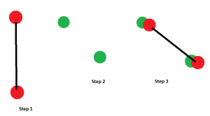

If you can see the picture attached, that might help. Note that the final position of the rope might mean using the ObiCursor real quick too. Because the desired length might be longer or shorter. But again, getting the correct length has not been much of a problem for me.
