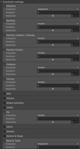

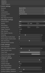

This is solver:

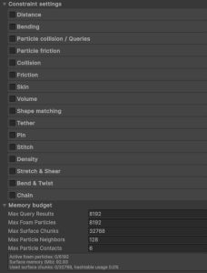

For create scene (where I do not need any simulation, only render), I have all constraints disabled:
Normal solver, in the game:
If you want, I can send you the whole scene, of course only the scene without all the junk, and you can check it out yourself what I'm doing wrong.

If you want no simulation but still update meshes, bounds, and everything else (which seems like the sensible thing to do in a "creator"/"editor" kind of situation) keep the solver enabled but set its max steps per frame to zero. This will allow no physics steps during each frame, so time won't advance.
Entirely disabling the solver will disable simulation update, bounds update, rendering update, etc which you don't want in this case.

(22-05-2025, 09:08 AM)Paul1 Wrote: For create scene (where I do not need any simulation, only render), I have all constraints disabled:
Note this won't stop the simulation: particles will still move due to gravity, wind, forces, etc. Disabling all constraints only prevents particle velocities/positions from being constrained to each other or to objects in the scene.
