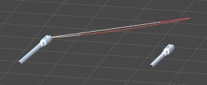

Bug / Crash  Issue with Grasping ObiRope Using Two ToolsGood morning, I’m encountering a strange
Good morning,
I’m encountering a strange issue with grasping a closed-loop ObiRope using two tools. My goal is to grasp different points on the rope with each tool, without using constraints.
The Problem:
  • If I grasp the rope with the left tool first and then with the right tool, everything works as expected. Both tools hold their grasping points correctly.
  • However, if I grasp the rope with the right tool first and then with the left tool, the following happens:
    • The right tool keeps its constraint but the grasped particle shifts to a position far away from the intended grasping point, while still visually connected to the tip of the tool.
    • The rope responds to tool movements but maintains this unnatural offset for the right tool.
  • The issue only happens when the right tool is the second to grasp, and it occurs inconsistently.
I’ve attached an image showing the situation. The rope becomes distorted, with the grasped particle connected incorrectly.
What I’ve Tried:
  • Confirming the attachments are created dynamically at runtime without pre-existing constraints.
  • Checking that particle indices are updated correctly during grasping.
  • Ensuring the tools have unique attachment components.
Image Explanation:
In the attached image:
  • The left tool is holding the rope correctly.
  • The right tool exhibits the described offset issue when grasping second.
Question: Why does this behavior occur when the right tool is the second one to grasp? Could this be a bug in ObiRope's particle attachment system, or am I missing something in the setup?
Thank you for any insights or suggestions!

now the image should be there, sorry
this is my code

Also i noticed that i the the following error when at runtime i click on the partcile Group menu in the obi Attachment component
NullReferenceException: Object reference not set to an instance of an object
Obi.ObiParticleAttachmentEditor.OnInspectorGUI () (at C:/Users/Alice Catalano/Desktop/Alice/ObiTraining/Assets/Obi/Editor/Common/Utils/ObiParticleAttachmentEditor.cs:75)
UnityEditor.UIElements.InspectorElement+<>c__DisplayClass72_0.<CreateInspectorElementUsingIMGUI>b__0 () (at <9920ff0c944845d7b9f9a61ef1478edc>:0)
UnityEngine.GUIUtilityLenguarocessEvent(Int32, IntPtr, Boolean&)
and this path doesn't exist anymore. I cleared the cache and rebuilt but still this happens
Hi Alice,
The following code is unnecessary, and may lead to incorrect behavior as it resets the state of the rope every time you attach a particle:
actor.solver.RemoveActor(actor); // Refresh the actor in the solver
actor.solver.AddActor(actor);
Debug.Log("Actor re-added to solver.");
What this does is take out all particles and constraints from the solver and reorder all other actor's data (which is expensive), then re-add the actor using the data stored in the blueprint. Adding attachments at runtime does not require doing this.
Additionally you're adding new particle groups to the blueprint:
actor.blueprint.AppendNewParticleGroup("GraspedParticles");
but never deleting them. This might not be a problem but over time can add up to a significant amount of scriptable objects being created.
Also keep in mind that having multiple attachments on the same particle will yield undefined behavior as warned in the manual. Your code does not check whether the particle about to be attached is already attached, so in case both left and right hands grasp the same particle you'll be in trouble:
Quote:Particles affected by more than one attachment will follow the attachment that was updated last. The update order for attachment is undefined.

Thank you for the answer, but unfortunately all of this work is lost.
yesterday my laptop crashed while the simulaiton was running and now seems like the simulation is not able to run anymore without continous lags.
I created another simulation that would have the same objects and behaviours but when I imported obi and used the same exact codes nothing was working anymore.
 the behavior of the elastic is totally different even if i keep the same values of the characteristics. Now when i grasp it the grasped particle is visually detached from the grasping point and the elastic "updates" when i grasp it, by fastly appearing and disappearing. the code is exactly the same as the one i provided you before.
(12-12-2024, 11:34 AM)alicecatalano Wrote: the simulation is not able to run anymore without continous lags.
Hi Alice,
If you're using Burst in the editor, make sure the jobs debugger is disabled as that will have a *huge* negative effect on performance.
(12-12-2024, 11:34 AM)alicecatalano Wrote: I created another simulation that would have the same objects and behaviours but when I imported obi and used the same exact codes nothing was working anymore.
Code can't just stop working due to a crash, it is impossible. More likely your current setup and/or parameters are not entirely identical to the original one.
(12-12-2024, 11:34 AM)alicecatalano Wrote: Now when i grasp it the grasped particle is visually detached from the grasping point and the elastic "updates" when i grasp it, by fastly appearing and disappearing. the code is exactly the same as the one i provided you before.
If the code is the same but behavior is different, that means the parameters used for simulation are not the same. I can't possibly know however, since I don't know how your project was set up before this incident and how it is set up now.
let me know if I can be of any help,
