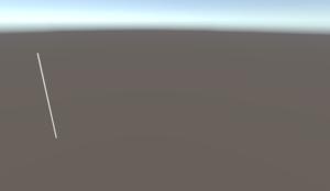

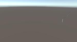

24-01-2024, 11:27 AM
(This post was last modified: 24-01-2024, 11:28 AM by HPx___.)
It's better but I still have inertia in the rope.
Before move
After move
My rope is created by this code :
Code: // Rope
