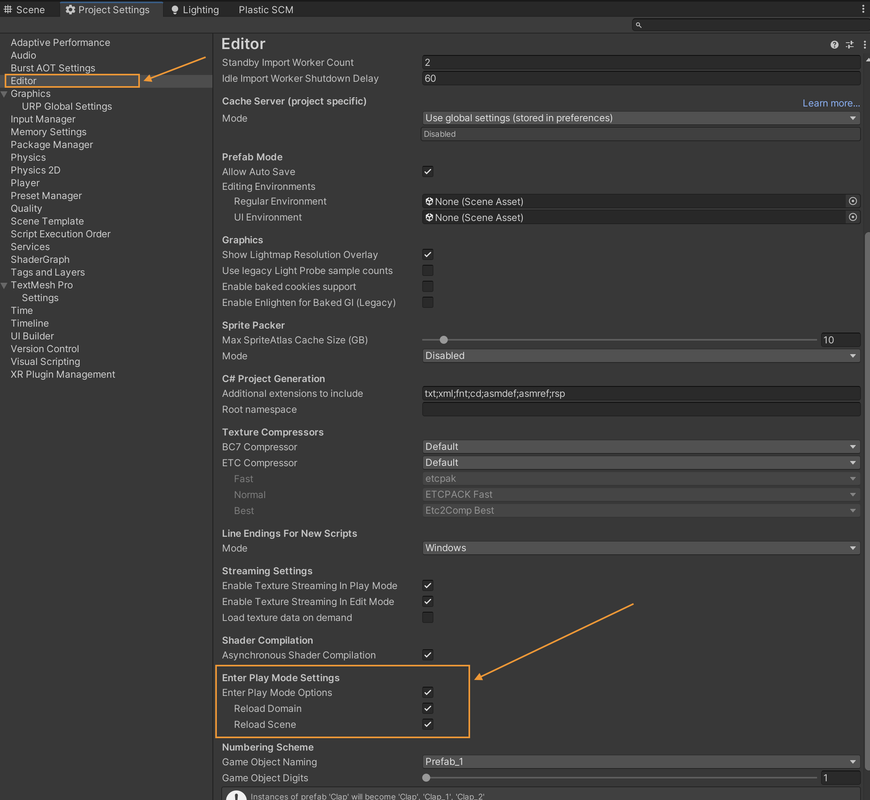

--- figured it out ---
Awake isn't called (and I guess on many other important components too) when you have Scene reload disabled
(I am stupid, hopefulyl this spares someone else the hours to find out)
