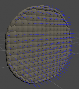

3D mode:
.jpg   3dmode.jpg (Size: 28.6 KB / Downloads: 59)
2D mode:
.jpg   2dmode.jpg (Size: 27.82 KB / Downloads: 59)

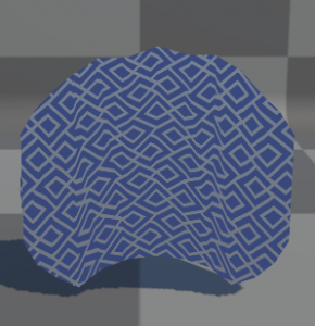

hi, i made a circular one but look weird in 2d mode. Did i do something wrong?

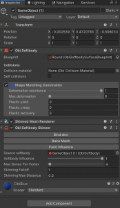

What are your blueprint settings? Where is the ObiSoftbodySkinner component placed? is it in the same transform as the softbody?

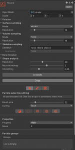

Yes, obi in 2d mode. here are some screenshots
