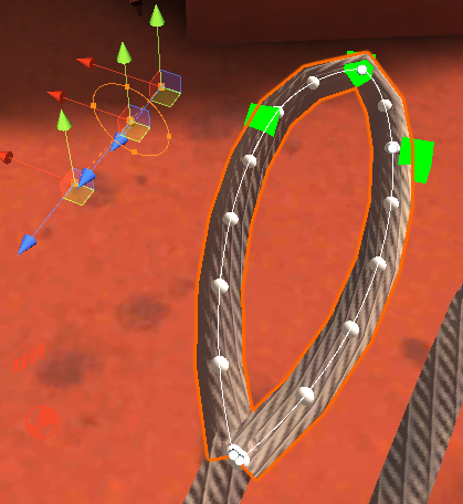

I havn't had time to test it yet. But regarding the broken ropes, it seems to happen consistently when I duplicate a rope, duplicate the blueprint, and then apply the new blueprint to the rope. I lose control over the rope like so:
![[Image: rope-broke.png]](https://i.postimg.cc/4nk9fGyf/rope-broke.png)
If I then revert the blueprint to the original one that the rope was cloned with, it updates to the changed blueprint but is still broken with the particle controls:
![[Image: rope-broke-2.png]](https://i.postimg.cc/NG7DMPYN/rope-broke-2.png)
