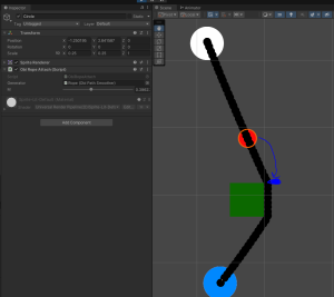

I am using this code but I am not getting the result I want, where am I going wrong?
My code;
int particleIndex = contact.bodyA;
Vector2 contactPoint = solver.positions[particleIndex] + contact.normal * contact.distance;
int activeParticleCount = rope.activeParticleCount;
float mu = 0;
if (activeParticleCount > 1)
mu = (float)particleIndex / (activeParticleCount-1);
col.GetComponent<Item>().muValue =(mu);
Debug.Log("mu: " + mu);Even if I try it in reverse as "1f-mu", I can't get the result I want.
As an additional question, I am extending this rope and I need to reset it to its initial state at the end of the game. How can I proceed?
