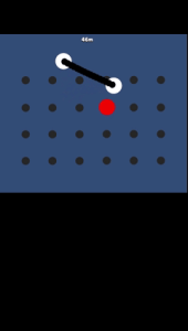

I'm sharing a video, even though I increased the particle frequency, it can pass through when I move it a little faster.
Hey,
I marked the obi rigidbody kinamatics inside the obstacle I wrapped and rope.selfCollisions = false;
rope.surfaceCollisions = false; and the shaking stopped.
My only problem right now is to reduce the tension of the rope. Sometimes it can be too loose.
