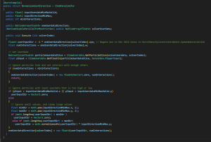

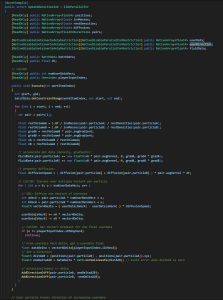

Attached are the Obi job and hacky helper, plus another job that Inverts a mysterious -1 bias. It also allows filtering InputDirections based on how many particles they interacted with, how much Input userdata is there, etc. In the job to add particle forces, I normalize the InputDirection.

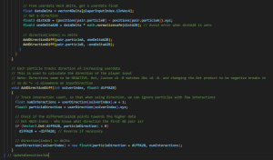

The hack solution involves checking a Dot Product on previous directions, then perhaps flipping the Direction*Data we are trying to add.
It seems like early interactions my bias later dot products, but I'm not sure.
// Each particle tracks direction of increasing userdata
// This is used to calculate the direction of the player input
// Note: Directions seem to be NEGATIVE. But, Custom +A -B matches Obi +A -B. and changing the Dot product to be negative breaks it
// so do *= -1 elsewhere on inputDirection
void AddDirectionDiff(int solverIndex, float3 diffA2B)
// Track interaction count, so that when using Direction, we can ignore particles with few interactions
float numInteractions = userDirection[solverIndex].w + 1;
float3 particleDirection = userDirection[solverIndex].xyz;
// Check if the differentialA2B points towards the higher data
// Dot HACK-iness - Who knows what direction the first AB pair is?
if (Vector3.Dot(diffA2B, particleDirection) < 0)
diffA2B = -diffA2B; // Reverse if necessary
// direction[index] += delta
userDirection[solverIndex] = new float4(particleDirection + diffA2B, numInteractions);
}But anyways - it's ok that 10% of directions are wrong, if I just increase particle input force by another 20%
