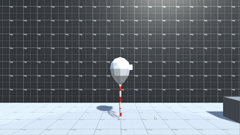

It working, this is with the prefab placed in the scene from the start:
![[Image: giphy.gif?cid=790b7611ce3aac377c22c6242e...y.gif&ct=g]](https://media1.giphy.com/media/LRayj77lFGgBjHK47z/giphy.gif?cid=790b7611ce3aac377c22c6242e9f7b44d58eb8ef8d6f09a9&rid=giphy.gif&ct=g)

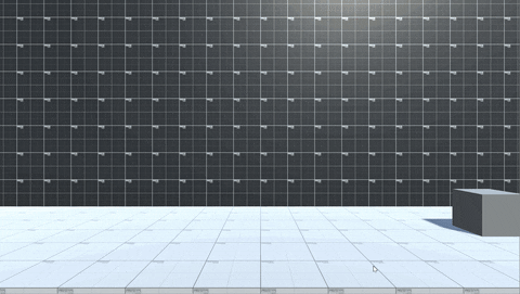

When the prefab is instantiated, no collisions events detected from that particle:
![[Image: giphy.gif?cid=790b76112f9596c9ab90c9faef...y.gif&ct=g]](https://media4.giphy.com/media/lpRstdtdtQnAgulYpl/giphy.gif?cid=790b76112f9596c9ab90c9faef05739950077e226e98c98d&rid=giphy.gif&ct=g)
