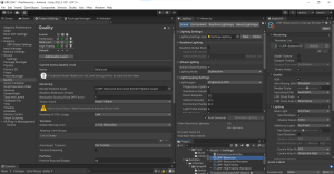

Can't reproduce this. What are your project's quality settings for Android, and your lighting settings for the scene? Indeed I have never changed settings yet, so quality settings has been set to URP-Baranced without any tweaks.
For the lighting, I don't touch any lighting or light settings of the FluidViscosty.scene.
This project only contains Obi7Fluid_beta and minimal assets for Meta Quest development because I newly created a project to scope down the source of issues.
I have another project which I have tweaked some quality settings such as lighting and shadows emits the exact same error though.
I attach a screenshot with which you may be able to grab some information of the project but if you need any other information, let me know please.
Thanks!

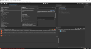

Could reproduce this, and found a somewhat strange solution: remove "Built-in" from the shader's compilation targets list in ShaderGraph:
Now, why would having an unused render pipeline in the list of targets affect compilation for an entirely different pipeline is beyond me. Imho, this is a bug in ShaderGraph.
let me know whether this fixes it for you too.
![[Image: 2CQAJzP.png]](https://i.imgur.com/2CQAJzP.png)
kind regards, By removing Built in from the Active Target, I got another error like this:
Code: Shader error in 'Shader Graphs/Master': Invalid conditional expression. at /UnityProjects/URP_Obi7/Library/PackageCache/com.unity.render-pipelines.universal@14.0.9/ShaderLibrary/Shadows.hlsl(284)
Thanks.
