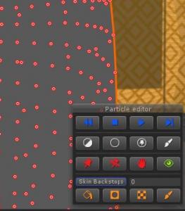

Can't edit skin on Particle Editor - adev eloper - 11-07-2018 Hi, I have recently purchased Obi Cloth and I am testing it for a clothing simulation project. It looks promising but I am unable to figure out why the skin properties values don't retain the values I set. I have attached a couple of screenshots of the particle editor. Can someone help? RE: Can't edit skin on Particle Editor - josemendez - 11-07-2018 (11-07-2018, 11:22 AM)adev eloper Wrote: Hi, Hi Jose, Make sure your mesh actually has a skin to work with. Skin parameters are ignored unless your gameObject has a SkinnedMeshRenderer. RE: Can't edit skin on Particle Editor - adev eloper - 11-07-2018 [attachment=157 Wrote:josemendez pid='1912' dateline='1531314721'] Hi, it has skinned mesh renderers like described below: GameObject - Obi solver: >body mesh - SkinnedMeshRenderer >shirt mesh - SkinnedMeshRenderer + ObiCloth >skirt mesh - SkinnedMeshRenderer + ObiCloth (shown on the image) RE: Can't edit skin on Particle Editor - josemendez - 11-07-2018 (11-07-2018, 03:20 PM)adev eloper Wrote: Hi, it has skinned mesh renderers like described below: Hi there, We're unable to reproduce this. What are your Obi and Unity versions? Also, when you select any particle in the cloth and switch to "Skin radius", a blue line should appear on top of the particle representing the radius. Does it appear at all? RE: Can't edit skin on Particle Editor - adev eloper - 11-07-2018 (11-07-2018, 05:07 PM)josemendez Wrote: Hi there, yes, it appears but I cannot change the value (the same for the skin backstop radius). The other attributes (skin backstop and stiffness) do not appear at all, as shown in the images. Obi version: 3.5 Unity: 2018.1.5f1 [attachment=158] [attachment=159] [attachment=160] [attachment=161] RE: Can't edit skin on Particle Editor - josemendez - 11-07-2018 (11-07-2018, 05:32 PM)adev eloper Wrote: yes, it appears but I cannot change the value (the same for the skin backstop radius). The other attributes (skin backstop and stiffness) do not appear at all, as shown in the images. Backstop and stiffness do not have a visual representation, because they're not distances or sizes, but physical attributes. That's completely normal. We're able to change the values successfully though, using Obi 3.5 and 2018.1.0f2. Will try your Unity version and get back to you. RE: Can't edit skin on Particle Editor - adev eloper - 12-07-2018 (11-07-2018, 05:48 PM)josemendez Wrote: Backstop and stiffness do not have a visual representation, because they're not distances or sizes, but physical attributes. That's completely normal. Hi josemendez, I was able to edit particles on the chan character. This is not a version issue. I found that my skinned meshes do not have root bones set up. I will add a rig to my character and try again. Are there any other unspecified requirements? RE: Can't edit skin on Particle Editor - adev eloper - 12-07-2018 (12-07-2018, 01:20 PM)adev eloper Wrote: Hi josemendez, I was able to edit particles on the chan character. This is not a version issue. I created a rig and binded skin to it before exporting to unity. It now works properly. |
