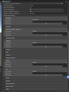

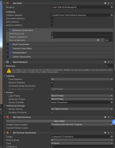

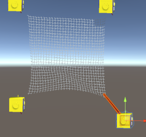

Hi Sir,
I have a question I would like to ask. I believe the Obi cloth has some compressive resistance, but I would prefer it to have sufficient flexibility. When dragging one corner inward, I do not want it to move the entire net, as shown in (https://flightpoint1.oss-cn-beijing.aliyuncs.com/2025-05-08-11-51-21.gif). Some parameter settings are shown in the attached picture. Could you please provide some suggestions for modifications?

RE: the Obi cloth has some compressive resistance - josemendez - 09-05-2025
Compressive resistance is controlled by the "max compression" parameter in the ObiCloth component. Yours is set tp 0.9 which means the rest distance between particles can get reduced up to 90% before they resist compression. Setting it to 1 will completely remove any compression resistance.
